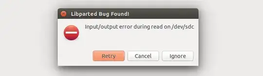

Whenever I try it using GParted, it wasn't opening normally. I got the following window:
Libparted Bug Found! - window
Help me resolve the issues and reuse my USB drive.

According to your comment the USB drive is broken. It looks as if one cannot format it or write to it in this state.
Some commands that are able to verify this by trying to read the drive are (assuming the device node is /dev/sdc):
sudo fdisk -l /dev/sdc
sudo dd if=/dev/sdc of=/dev/null bs=1m count=1
If they abort with an I/O error, the device is likely broken.
