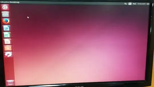

I have installed Ubuntu 14.04 in my machine(with Gigabyte motherboard), having an Acer 19" Monitor. Unfortunately its resolution not working properly. See the image.

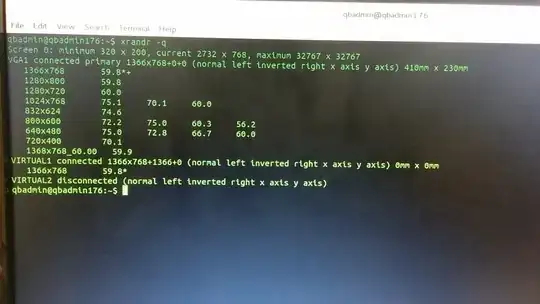

This is my xrandr -q output.

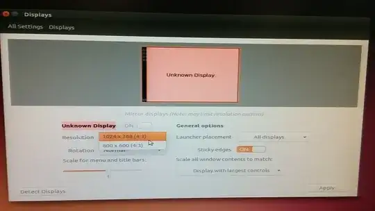

But when I take system settings for adjusting display it shows unknown display and only two resolutions available on the drop down as given in the picture.

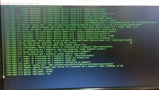

Please help me to correct the display resolution as I am a beginner to Linux and Ubuntu. This is my last 30 lines of /var/log/Xorg.0.log
