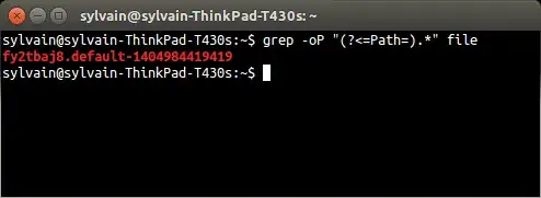

You can use grep and just grep:
grep -oP "(?<=Path=).*" file
Explanation:
From man grep:
   -o, --only-matching
          Print only the matched (non-empty) parts of a matching line,
          with each such part on a separate output line.
   -P, --perl-regexp
          Interpret PATTERN as a Perl compatible regular expression (PCRE)
The lookbehind (?<=Path=) asserts that at the current position in the string, what precedes is the characters Path=. If the assertion succeeds, the engine matches the resolution pattern.
For Perl 5 regular expression syntax, read the Perl regular expressions man page.
