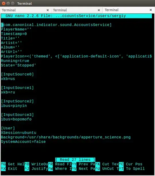

Next thing, you can actually change the user background the hard way. There is a profile folder for each user stored in /var/lib/AccountsService/users. For instance, /var/lib/AccountsService/users/sergiy is my account profile. What you can do is to edit that file with the text editor of your choice. I prefer nano. So what I type is this:
sudo nano /var/lib/AccountsService/users/sergiy
It will prompt for your password (considering that you're in sudoer group, of course) and open the file. Locate line starting with [User] and line saying Background . Paste the path to your desired wallpaper after = sign. For instance, here's mine: enter image description here
After you're done editing , reboot.
