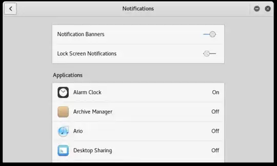

In my case is because of I accidentally disable Notification Banners settings.
Note that this answer might not relevant to OP case which claims that Pidgin is working. But it should help someone based on the question title.
