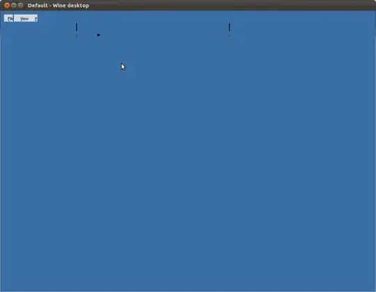

  10. WMP11 will open but it will be horrible as seen here:
    Press Enter 4 or 5 times to accept something that you can not see. I do not remember how many. Just do 5 and that should be enough.

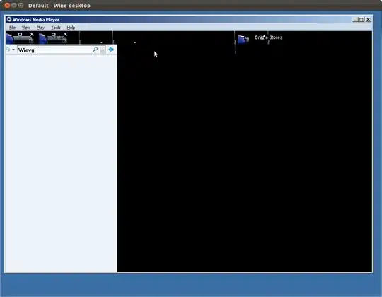

  12. Change winecfg from Windows XP to Windows 7.
  13. Open wmplayer.exe again. This time you should see a little bit more stuff like here:

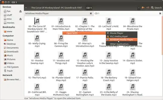

That is all. The option to run WMP11 can be found in the Open With option when right clicking in Nautilus, as seen here:

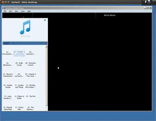

You can hear music, add mp3 lists and hear all songs from the list as shown here:

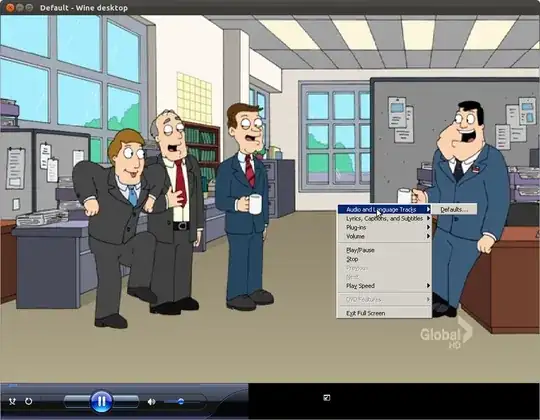

Lastly you CAN see a movie but you need to make it fullscreen to see it. Just press ALT+ENTER for fullscreen. The menu below while fullscreen will not work, instead just right click the video and the context menu should help. As shown here:
