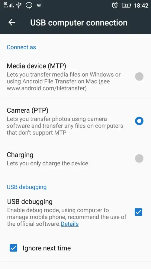

Same problem. Thousands of popups and file explorer windows would keep coming as soon as I connect my phone. I solved it by choosing "Camera (PTP)" in my phone instead of "Media device (MTP)" by clicking the usb notification.
