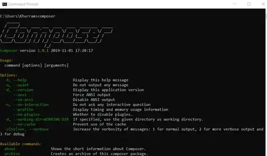

Follow below steps for laravel installation:
Install composer
curl -sS https://getcomposer.org/installer | php
sudo mv composer.phar /usr/local/bin/composer
sudo chmod +x /usr/local/bin/composer
After installation, on typing composer in terminal you'll get composer
