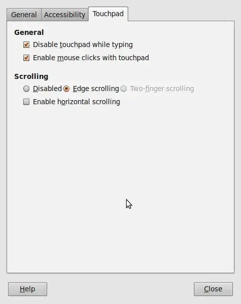

I can scroll with 2 fingers with my touchpad on Win7 but when I switch to Ubuntu 10.04 it doesn't work, the option is greyed out.
Could anyone help?
  • My touchpad is Synaptics V7.2 PS/2 Port

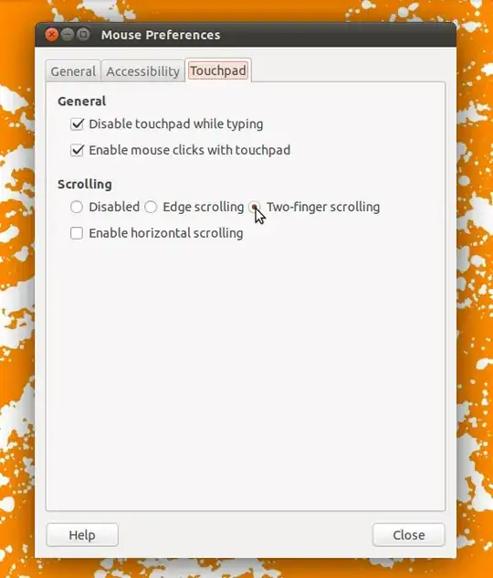

In Ubuntu this option is disabled by default, go to System > Preferences > Mouse, in the Touchpad tab select "Two-finger scrolling" and that's done. Select Two-finger scrolling
