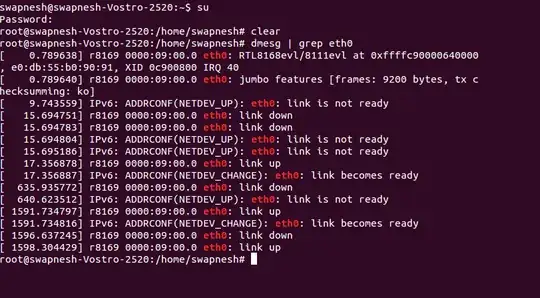

Command- dmesg | grep eth0
grep eth0

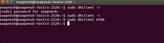

Command - sudo dhclient -r & sudo dhclient eth0
dhclient
I also restarted my network manager as suggested HERE
