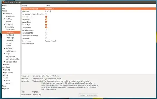

Ok, install dconf:
sudo apt-get install dconf-editor
open dconf under com>canonical>indicator>datetime:
and uncheck and check " show-clock ".
logout and login.
