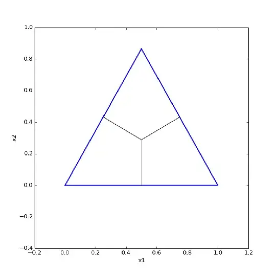

Here is an example which I would like to pause:

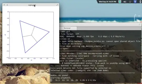

The simplest way to do it is play your gif animation in mplayer
Open your gif file in mplayer using following command
  mplayer -loop 0  -speed 0.2 your_gif
Here
-loop 0 means it will run your gif image untill you are not closing it and
-speed 0.2 means it will decrease the animation speed to 20%.
You can pause your animation by pressing the Space button .
mplayer will also show the frame information of your running gif in terminal.
