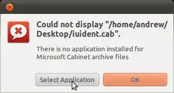

You can also configure the Archive Manager GUI to open cab files once cabextract is installed.
Double click on the cab file. You will be told that it can't be displayed, but that not actually true. Press Select Application.
alt text

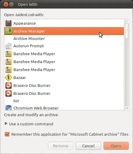

Select Archive Manager from the "Open With" dialog and check the "Remember this application" box.
alt text
Now you can handle cab files like zip or rar files. You can use the "Extract here" right click option or double click to open in Archive Manager.
