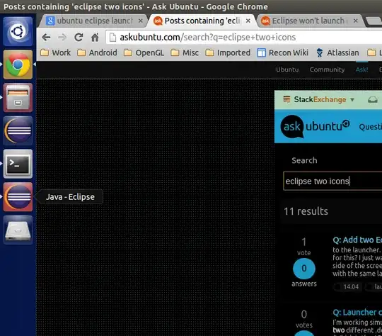

I recently upgraded to Eclipse Luna and since then I've had trouble launching it from the Unity Launcher. I've modified my old .desktop file located in ~/.local/share/applications, then added it to my launcher and now it looks like this:
Valid XHTML
How can I fix this?
