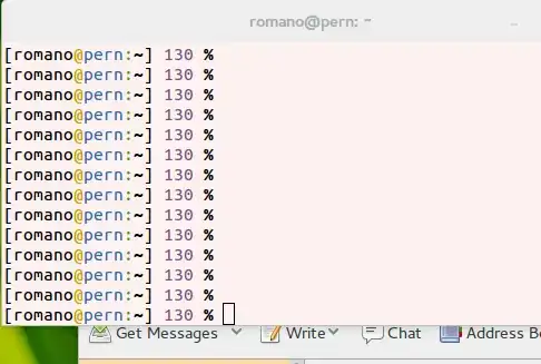

Another option is to use liquidprompt --- works for both bash and zsh, and can be easily configured to have the terminal title set and even to color in different colors the hostname in the prompt:
