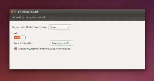

Go to
  • system settings
  • Brightness & Lock
Switch "Turn screen off when inactive for" to "Never"
Never switch off
For Xubuntu :
Go to "Power Manager"
Tab "On AC"
Tab "Monitor".
Set "Switch off display when computer is inactive" to never
