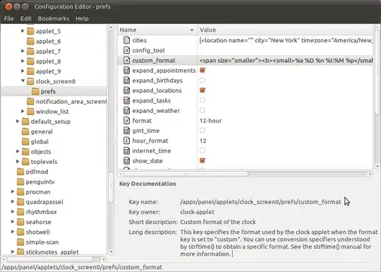

Yes, you can do this with the standard Ubuntu clock.
Open the gconf-editor and navigate to apps -> panel -> applets -> clock_screen0 -> prefs. You can then set the key custom_format to any format you want, e.g. %Y-%m-%d %H.%M.%S should give the format you want. You also have to set the key named format to custom so that your custom format is used.
The custom format can also contain HTML formatting, so you could use something fancy like <b>%Y-%m-%d</b> %H.%M.<span color=”#888888″>%S</span> to display the date in bold and the seconds in grey...
The GNOME Clock is actually very customizable once you dig into the gconf settings.
Launch gconf-editor from the terminal or the "Run Application" dialog (Alt-F2).
Navigate to /apps/panel/applets/clock_screen0/prefs/custom_format
gconf
Take a look at man strftime for the different variables you can use there.
You also need to set /apps/panel/applets/clock_screen0/prefs/format to custom for your changes to take effect.
