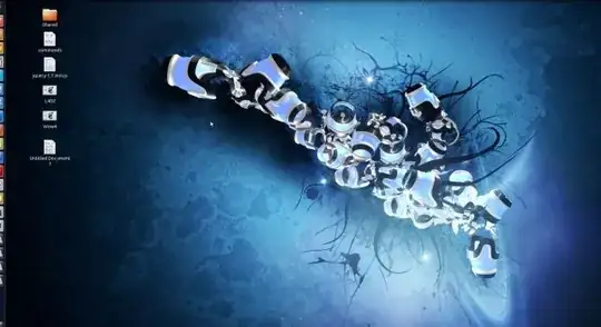

Is there a way to set the screen borders manually? Right now, when I have it connected to my TV via HDMI, the edges of the screen are cut off. It looks something like this that I found from another question:
As you can see, the launcher is cut off
Card: AMD Radeon HD 4890 TV: Panasonic th-50px60u

What you are looking at is a feature called "overscan" (or "zoom" on some TVs). It's the TV itself cutting off the edges!
So, look for a feature called overscan (or zoom) in the setup of the TV, and disable it!
