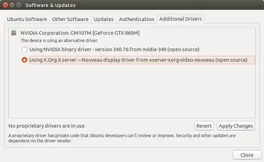

Then press the Super key (usually the Windows logo on your keyboard), type Additional Drivers and press Enter. You should now have a choice of driver to use:
Additional Drivers screenshot
Select "Using NVIDIA binary driver - version 340.76 from nvidia-340 (open source)", enter your password and press Apply Changes.
Restart your computer and enjoy! You should have access to a new NVIDIA settings tools called "NVIDIA X Server Settings" (press the Super key and type "nvidia" to look for it).
