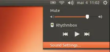

First step, just to verify, check if the sound is not muted. Once you verify this, go to

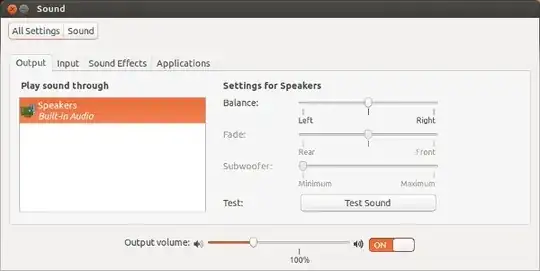

Sound Settings:
In the Sound Settings, you’ll find that you have practically nothing here except a dummy output. Quite frustrating. It means that your sound card is not even recognized. Puff!

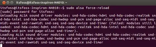

No worries. The one shot solution which fixed the sound problem for me on my Intel powered Dell Inspiron N4010 is to force reload Alsa. To do that, use the following command in terminal (Ctrl+Alt+T):
sudo alsa force-reload
The output will be like this.
You may think that it is hanged or still in processing but it takes only couple of seconds. You can simply close it afterwards by using Ctrl+C. Now, you need to reboot your computer. If at the next start up, you hear the login sound at the lock screen, you know it worked like a charm.
