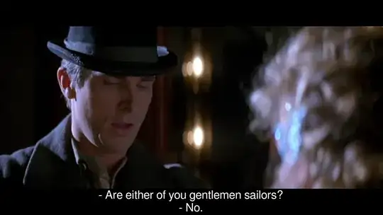

If initially the subtitles look like so:
After changing settings I do not want them to look like so:
Example: follow the instructions up to the third step, type in 222 pixels, and follow the rest of the instructions. Now you should be able to see that this is not desirable in any way. I am surprised no one complained.
Question: how do I move the subtitle under the video without it distorting the image in any way?

The height of the video is shrunk by the same factor as the width. I do not see any distortion, it is just a scaling which conserves the aspect ratio of the video. But it would be desirable that the video area is not shrunk. This seems to be impossible with vlc. After the "padding", you can adjust the area of the video by shiftig the window borders. That way, you can obtain approximately the desired result.

  1. when the picture has a black space below it, it also has a black space above it, and so the picture is not squeezed, but moved upwards, while the above space is diminished (notice that in the images below).
Before:
After:
