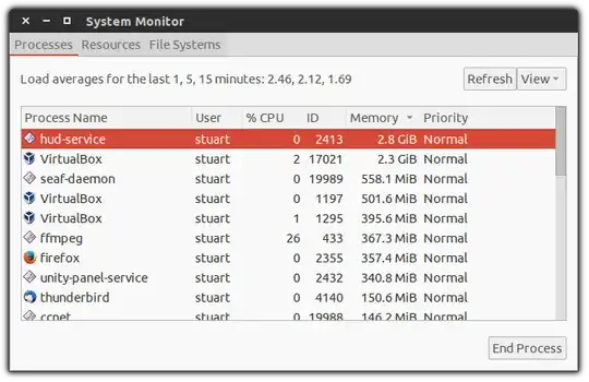

I just disabled the hud-service because it was taking up 2.8 GiB of my computers RAM.
I understand that it is part of the unity ecosystem because others are posting solutions along the lines of installing xubuntu etc. However, I like running stock-ubuntu as this tends to make asking for help and diagnosing issues easier (just my opinion).
Question
Could someone explain to me what this service is responsible for, and thus what I am sacrificing by disabling this service?
Possibly Related Info
I use synapse for searching/starting applications, and always have the unity-side launcher/dashboard hidden and never use it. I switch between applications using the compiz ring-switcher which is set to display everything from all workspaces, and the desktop "wall" combined with expo.
