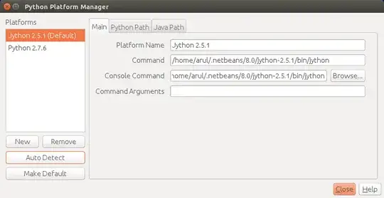

But when I click Auto Detect in Python Platform Manager (Netbeans IDE 8.0.1) am am not getting 3.4.1 in the list(Shown below).
How to solve it ?

Select "New" there in the "Python Platform Manager".
Then It will open a dialog box.
Navigate to /usr/local/bin and select python3.4.
AT least that works on Windows.
If the dialog box does not appear, then in the command field of the new profile type
/usr/local/bin/python3.4
and in Console Command type the same thing. In platform name type Python 3.4.1 That will fix your problem.
