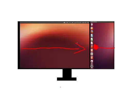

Running Xubuntu 14.04 on a Mac Mini, using open source ATI driver (more info below).
After some time running in Xorg, the display 'rearranges' itself so the beginning and the end of the screen (at least, horizontally) are in the wrong place.
Restarting the X server does not appear to do anything (if I kill X entirely, the terminal has the same display issue ... it starts at the wrong place).
Rebooting the system fixes up the problem.
Not sure what to call this issue - where should I start looking?
artist rendition

Because Ubuntu 14.04 open source drivers come together with a peculiar video patch, the chances to install official drivers for ATI cards are slim sometimes and not so slim other times. I was under the impression that this patch error affects only NVIDIA video cards but it seems that ATI video cards can have the same issues.
Sometimes open source drivers work like a charm with ATI cards, and sometimes you get funny results like in your case. To fix the problem you are supposed to remove your ATI drivers from your system, remove xorg.conf, and after that reinstall xorg completely and finally reconfigure Xorg.
All this operations are better performed in the console terminal, and to get to the console you have to press Ctrl+Alt+F1 at login prompt, and login with your username and password. So it would be better to write down these commands on some piece of paper before actually running them.
  sudo apt-get purge fglrx*
  sudo rm /etc/X11/xorg.conf
And to reinstall xorg completely:
  sudo apt-get install --reinstall xserver-xorg-core libgl1-mesa-glx:i386 libgl1-mesa-dri:i386 libgl1-mesa-glx:amd64 libgl1-mesa-dri:amd64
immediately followed by:
  sudo dpkg-reconfigure xserver-xorg
and finally
  sudo reboot
The following is a well documented guide addressed to fixing the proprietary ATI drivers, the one I used to address your problem. I have no idea whether it will work for you, I never used ATI video cards but I think you should also read the comments to this guide because there are a few interesting suggestions in there too.
