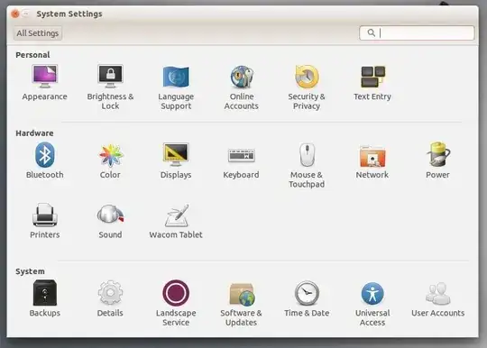

I've looked around to try to find an option, and I followed this question. But I don't have that panel on my ubuntu. My system setting is different:
system settings panel
As you can see I have no "keyboard layout" icon. there is a "text entry" icon that has the same design but does a totally different thing and I cannot change keyboard there.
Inside language support There is a keyboad langua (in the regional panel) but I cannot choose the keyboard that I want, only available keyboards for english language.

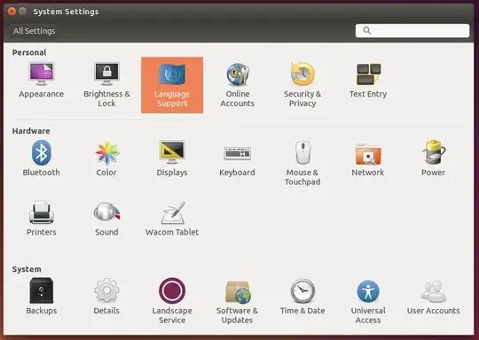

  1. First, click on the "Language Support" System settings

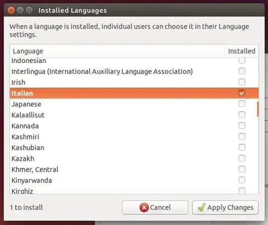

  2. Install the desired language by clicking "Install / Remove Languages..." Language support
  3. Italian, in this case Install / Remove Language

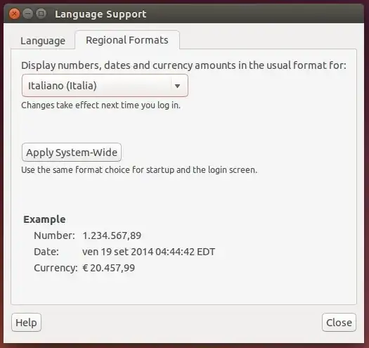

  4. After it's done, go to "Regional Formats".
    Eccolo! The language you just installed will be available there. enter image description here
