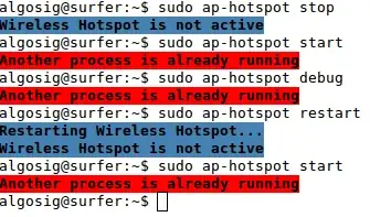

ap-hotspot is configured, when i first entered the command sudo ap-hotspot it said starting wireless hotspot which took long time but didn't start. Afterwards it displays following errors:
I found the solution to my problem from Internet. By removing the pid file in /tmp I got rid of this error "Another process is already running"
sudo rm /tmp/hotspot.pid
then start ap-hotspot as,
sudo ap-hotspot start
