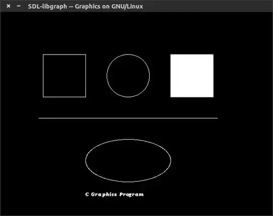

Using SDL
If you want to use graphics.h on Ubuntu platform you need to compile and install libgraph. It is the implementation of turbo c graphics API on Linux using SDL.
It is not very powerful and suitable for production quality application, but it is simple and easy-to-use for learning purpose.
You can download it from here.

  5. Now you can use #include<graphics.h> on Ubuntu and the following line in your program:
    int gd=DETECT,gm;
    initgraph(&gd,&gm,NULL);
Here is a sample program using graphics.h:
/*  demo.c */
#include <graphics.h>
int main()
   int gd = DETECT,gm,left=100,top=100,right=200,bottom=200,x= 300,y=150,radius=50;
   rectangle(left, top, right, bottom);
   circle(x, y, radius);
   bar(left + 300, top, right + 300, bottom);
   line(left - 10, top + 150, left + 410, top + 150);
   ellipse(x, y + 200, 0, 360, 100, 50);
   outtextxy(left + 100, top + 325, "C Graphics Program");
   delay(5000);
   closegraph();
   return 0;
  • To compile it use
    gcc demo.c -o demo -lgraph
  • To run type
    ./demo
Output of Demo 1

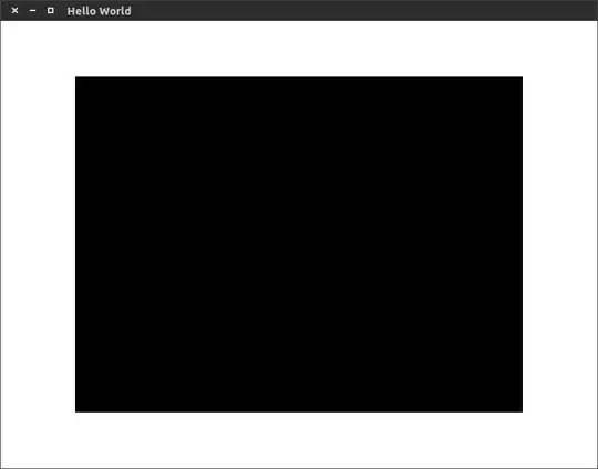

Using OpenGL (via GLUT)
Although OpenGL is basically made for 3D programming, drawing 2D shapes gives the basic outline and introduction to OpenGL and gives the idea about how to start drawing objects in OpenGL.
  • To install GLUT, open terminal and type sudo apt-get install freeglut3-dev.
  • Here is a simple graphics program using GLUT
/*  demo.c */

  • Compile it using
    gcc demo.c -o demo -lglut -lGL
  • Run it using
    ./demo
Output of Demo 2
