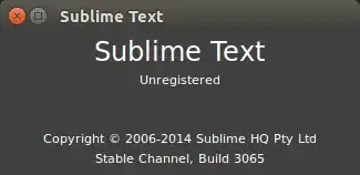

Hence, to get the version:
$ subl -v
Sublime Text Build 3065
As Glutanimate noted, you can get the version from the Help menu, from About Sublime Text:
