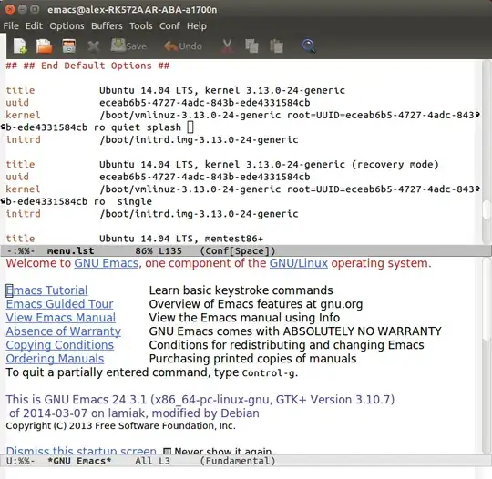

I am trying to edit this file to add "nomodeset" to the end of the line.
Is there any way to edit a buffer? Is there a work-around for this?
