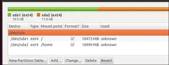

In simple word / is the root partition where Ubuntu stores it's system file where as /home is home partition where home directory of users is create.
If you want to protect your personal files during re-installation or in some other circumstances , you can install / and /home in two different partition.
  • Durring installtion in Installtion Type window select Something Else
  • After this you can edit your partition if you needed.
  • Select the partition on which you wnat to use as / and select Mount point as /.
  • Once you're done deleting, resizing, and creating partitions, select the partition on which you want to use as /home and select Mount point as /home. (Before going to next stem make sure both partition is of EXT4 type).
  • Click on Forward to proceed the installation.
