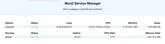

@Adrian answer is what helped me find what I needed, but in more detail of what I did that totally worked.
The key for me was that I installed monit as a solution that could monitor the proftpd process and make sure it was running at all times, if it detects the service not running then it would start it.
First
Make sure to update and upgrade first
apt-get update
apt-get upgrade
Second
Download and install monit
apt-get install monit
Third
cd /etc/monit/
vi monitrc
find the commented line set httpd port 2812 and and uncomment/change it to
set httpd port 2812
remove "and" if you want to be able to access it NOT from localhost only but instead remotely
Then ONLY uncomment line
allow admin:monit
This is the user authentication credentials you will need to login, change them as you want
Then add this in the file, I added mine at the bottom of the page. Change your port number to match yours, otherwise default is 21
check process proftpd with pidfile /var/run/proftpd.pid
start program = "/etc/init.d/proftpd start"
stop program  = "/etc/init.d/proftpd stop"
if failed port 21 protocol ftp then restart
Then just restart service
/etc/init.d/monit restart
You're done and... your welcome! Here is a nice pic to show you what it looks like
Monit Dashboard Example
You can access the web interface from youripordomain.com:2812
Monit will constantly check for the service and if not running will start it. Great tool for any service you want to check.
