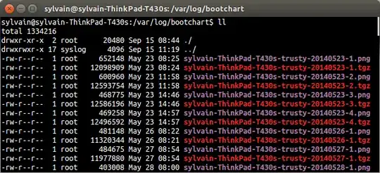

Then all you have to do to (re)generate a png picture of your boot sequence is to select an archive in /var/log/bootchart/, for example:
$ cd $HOME
$ bootchart /var/log/bootchart/sylvain-ThinkPad-T430s-trusty-20140915-1.tgz

But by default bootchart saves png in /var/log/bootchart/ too:
