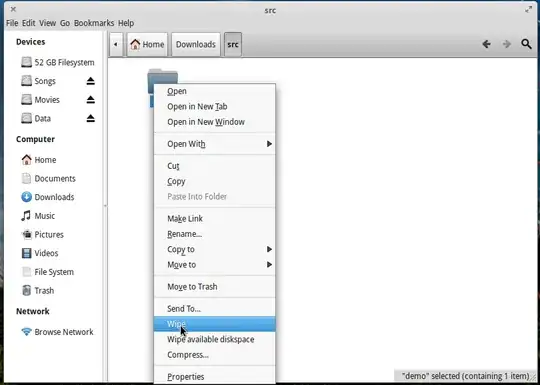

If you want to shred file or folder you can use nautilus-wipe Install nautilus-wipe . It is a nautilus extension that adds shredding data options in nautilus right-click menu.
  • You can add it to you nautilus using sudo apt-get install nautilus-wipe.
  • Now restart your nautilus using nautilus -q and then starting it either opening it from Dash or using Alt+F2 and entering nautilus.
  • Now you can find a wipe option in nautilus right click menu.

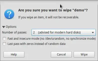

  • Selecting this option will open a pop-up window (with some additional option).
  • Click on OK to wipe you data completely.
