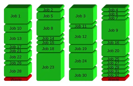

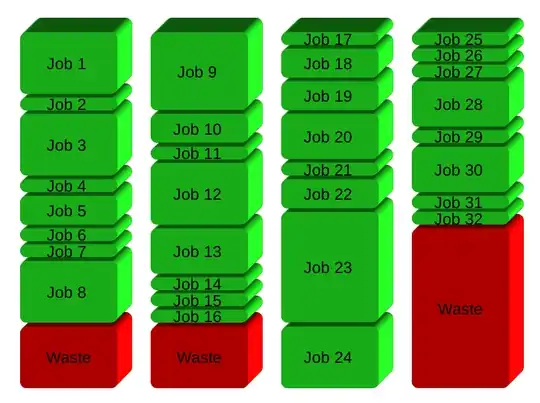

If you have GNU Parallel you can run:
seq 10 | parallel -N0 doit
All new computers have multiple cores, but most programs are serial in nature and will therefore not use the multiple cores. However, many tasks are extremely parallelizeable:
  • Run the same program on many files
  • Run the same program for every line in a file
  • Run the same program for every block in a file
GNU Parallel is a general parallelizer and makes is easy to run jobs in parallel on the same machine or on multiple machines you have ssh access to.
If you have 32 different jobs you want to run on 4 CPUs, a straight forward way to parallelize is to run 8 jobs on each CPU:
Simple scheduling
GNU Parallel instead spawns a new process when one finishes - keeping the CPUs active and thus saving time:
GNU Parallel scheduling
