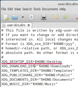

  • Open the ~/.config folder. (Press Ctrl+h to show hidden folders.)
  • Open the user-dirs.dirs file in gedit.
  • Change XDG_DESKTOP_DIR to the folder you want to show as your Desktop folder. In your case it is XDG_DESKTOP_DIR=$HOME/Desktop
  • Now restart nautilus using nautilus -q or killall nautilus and again opening it from Dash.
