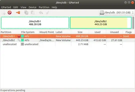

I had the same problem, one of my drives with NTFS format was not able to mount.
I ran the command below :
sudo gparted
The result was shown in the below image
When I tried to mount it, this message was shown
Unable to read the contents of this file system! Because of this some operations may be unavailable. The cause might be a missing software package. The following list of software packages is required for ntfs file system support: ntfs-3g / ntfsprogs.”
I installed ntfs-3g using
sudo apt-get install ntfs-3g ntfs-config
After that I ran:
sudo ntfsfix /dev/sdb1
It worked for me
