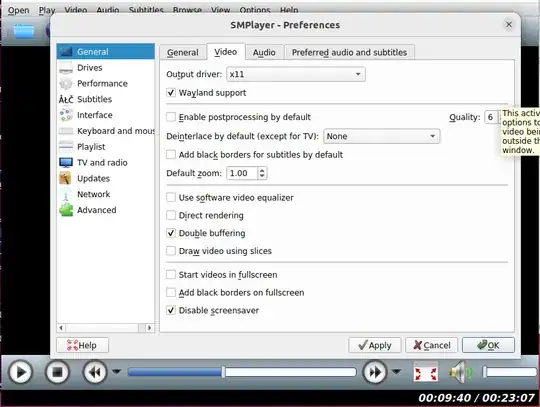

In the Preference → Video, setting of SMPlayer, I changed the 'output driver' from 'default' to 'x11'. Video worked. Video files were encoded with MP4 and MKV(HEVC)
Also if you install SMPlayer with Snap repository, you'll need to go to 'Ubuntu Software' manager and adjust its permission to be able to read file off a removable drive like USB and encrypted partitions.
SMPlayer setting location
