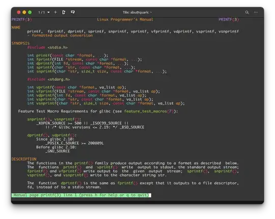

I suggest a very nice tool called batcat provided by https://github.com/sharkdp/bat.
bat package is available on Ubuntu since 20.04 ("Focal") and Debian since August 2021 (Debian 11 - "Bullseye")and its command is batcat which is a cat replacement with wings.
From the git docu:
man
bat can be used as a colorizing pager for man, by setting the MANPAGER environment variable:
bash export MANPAGER="sh -c 'col -bx | batcat -l man -p'"
It might also be necessary to set MANROFFOPT="-c" if you experience formatting problems.
If you prefer to have this bundled in a new command, you can also use batman.
Note that the Manpage syntax is developed in this repository and still needs some work.
Also, note that this will not work with Mandocs man implementation.
Install this bat package
sudo apt install bat
I love the Monokai theme and therefore I added this command into my .zshrc:
export MANPAGER="sh -c 'col -bx | batcat -l man -p --theme 'Monokai Extended''"
In case you are using fish shell add this line to your ~/.config/fish/config.fish file:
set -x MANPAGER "sh -c 'col -bx | batcat -l man -p --theme 'Monokai Extended''"
A list of installed color-themes can be printed by following command
batcat --list-themes
Here a screenshot of man 3 printf
