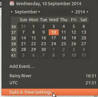

I have been trying to access the Date and Time setting in my Ubuntu 14.04 to modify the time (which is wrong).

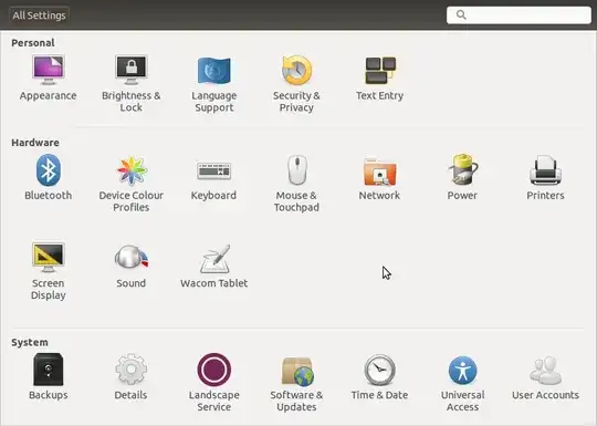

I click in the hour in the top-right corner of the top bar, and then in "Date & Time Settings..." 1. Instead it takes me to "System Settings" 2. If I tried to click on "Time & Date" in "System Settings", it just closes the "System Settings" screen.

try to type "Time" (without the quote) in the right top search box of the "All Settings"
But likley this will crash too. Please start the "All Settings" / System Settings via command line: gnome-control-center
and try to access Date & Time, if it crash the terminal might give you an inside why.
Otherwise you can set the date and time via command line (see here: What is the command line statement for changing the System clock?)
