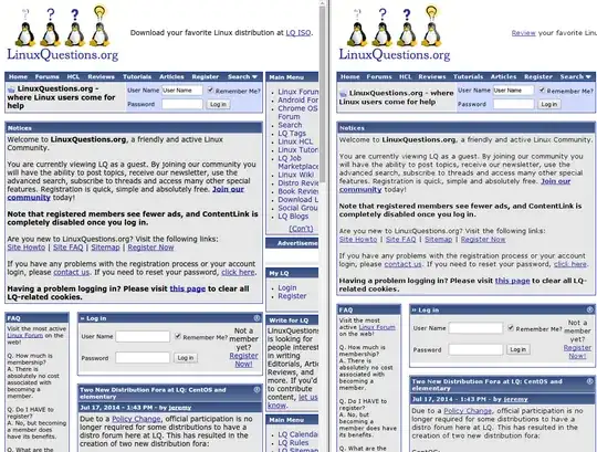

Here a screenshot that would explain it. On the left, it is a newer version of Chrome. And on the right an older one which I definitely prefer. The fonts are sleek and sharp: enter image description here

First, go to the Kubuntu font settings,
see how different settings work for
antialiasing, subpixel rendering, and hinting.
That was the minimal set of important font options.
If you want to see the maximal set of font options, try infinality:
You need the ppa ppa:no1wantdthisname/ppa
For how to use it, and important notes to read before, see launchpad: Better font rendering ppa.
Install is with
sudo apt-get update
sudo apt-get install fontconfig-infinality
See /etc/profile.d/infinality-settings.sh for setup.
$ grep -Eo '^export INFINALITY_[^=]+=' /etc/profile.d/infinality-settings.sh | sort -u
