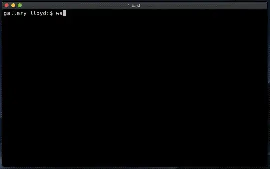

Install local-web-server, it installs the ws command which you can run to serve any directory as a static site.
This clip demonstrates static hosting plus a couple of log output formats - dev and stats.
Static static log output
