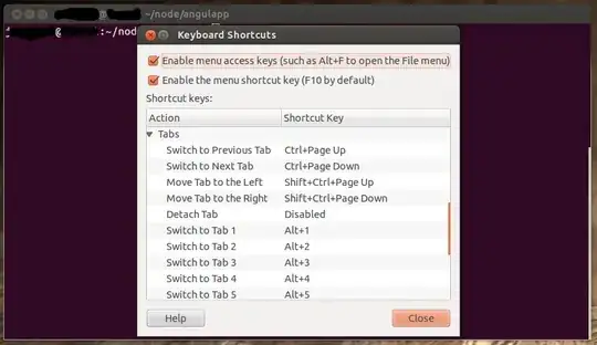

I'm guessing you mean the default distributed (pre-installed) gnome-terminal.
You can set your own shortcuts easily, just go to menu Edit>Keyboard Shortcuts...
gnome-terminal keyboard shortcuts settings as seen on ubuntu 12.04
Bonus tip: If you wanna take a look to the real "native terminal" or tty (teletype interfase) just hit Ctrl+Alt+F1 (It works with almost any Function key), and don't panic, you can come back to the "graphical interfase" by hitting Ctrl+Alt+F7
