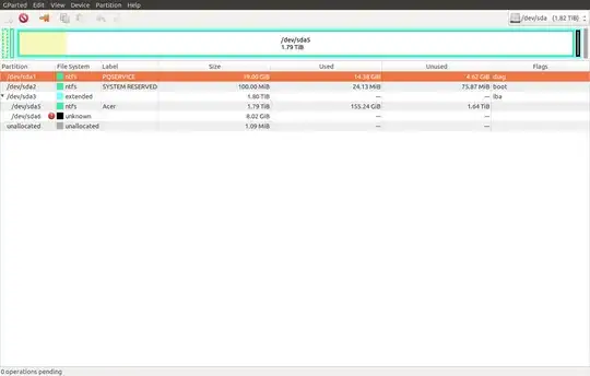

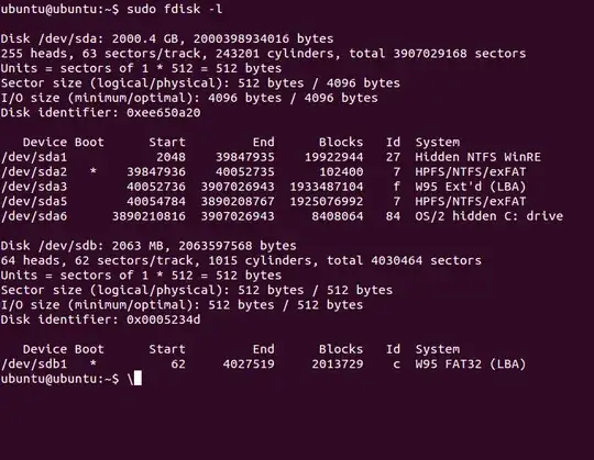

The best option seems to be to shrink the main C: drive (/dev/sda5 in the screenshot below), then install Ubuntu on the newly freed up space. My question, though, is can I get rid of the Recovery (sda1), System Reserved (sda2) and Hibernation (sda6) partitions as well? This is a desktop so I don't need hibernation and I have recovery disks that work fine. But will the deletion of these prevent me from using my Win 7 partition?
Screenshot: GParted Screenshot
Screenshot: fdisk Output

Alright, figured it out. I kept the Recovery but I deleted the Hibernation Partition.
In Windows, I turned hibernation off with the "powercfg.exe -h off" command in the terminal. Then, in Disk Management, I deleted the Hibernation Partition then extended the Acer partition into it. The problem, though, was that it was still an extended partition and when I tried to shrink it it would give me "Free Space" within the extended partition instead of the coveted "Unallocated Space" outside the extended partition.
Rebooted Windows to make sure everything was still working.
Then, I booted up my Live USB of Ubuntu and brought up GParted. First, I changed the size of the Acer partition "sda5" (within the extended partition "sda3") to give me about 500GB of free space. Then, I changed the size of the extended partition "sda3" to free up the free space into the unallocated space I needed.
Rebooted Windows to make sure everything was still working (again).
Then, I used the Live USB to install Ubuntu onto that unallocated space. I chose the "Something Else" option, created a 484GB "/" partition and a 16GB "Swap" (I know, too big, but I wasn't thinking clearly). I installed and then rebooted.
It booted right into Ubuntu without giving me the GRUB screen. Followed the directions from "GRUB does not detect Windows" and now it works like a charm!
