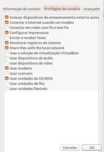

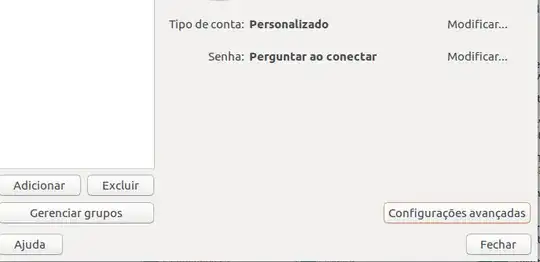

Do this:
sudo apt-get install gnome-system-tools
Then you have an interface to add users :
Whit many options :
