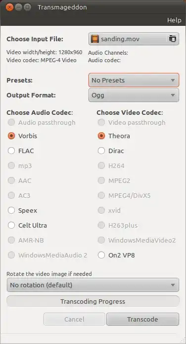

I personally like, transmageddon which is a GUI app with nice simple pre-sets. It's available in the archives.
transmageddon
