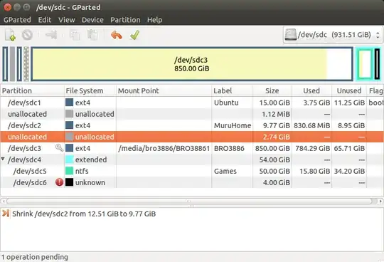

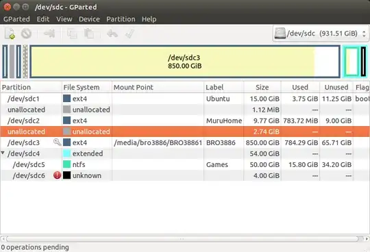

Marty may be generalizing. You can make changes to partitions before a mounted partition that do not affect the mounted partition. So you can shrink them, but not expand. enter image description here
