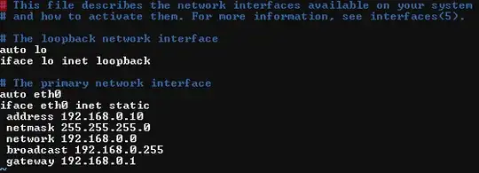

I just installed Ubuntu server 14.04.1 LTS on my old gaming pc to run a file server on. I got it all installed on the PC and was able to apt-get update and apt-get upgrade and install samba, openssh-server, smbclient, cifs-utils, ntp and ntpdate. I set up /etc/network/interfaces: .

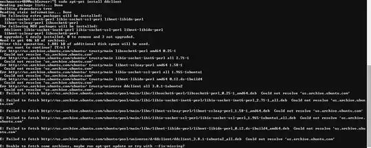

Everything looks right in there and I was still able to install packages and everything. Now, when I reboot the computer I try to install ddclient and I get:
Now I get this no matter what I try to install or update or upgrade. Any help would be appreciated!

In your /etc/network/interfaces file you need to add your dns servers. Try editing like below:
auto eth0
iface eth0 inet static
  address 192.168.0.10
  netmask 255.255.255.0
  network 192.168.0.0
  broadcast 192.168.0.255
  gateway 192.168.0.1
  dns-nameservers 8.8.8.8 4.2.2.2
Then run
sudo service networking restart
Try to ping
ping google.com
