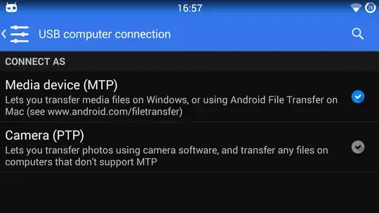

I have problems with my Ubuntu GNOME 14.04 installation recognizing my Nexus 7 at times, too. This is what works for me:
  1. Make sure the cable can transfer information, that it's not just a power cable.
  2. Make sure you have USB debugging enabled.
  3. Unlock your device.
  4. Connect your device to your computer.
  5. Your device should display a pop-up, asking if you want to accept a connection to your computer. (If you had this pop-up before, you might have ticked the "always accept a connection from this device" checkbox.)
  6. Normally, your device should now pop up in your favorite file manager. If it doesn't, check if ADB finds your device. In a terminal, type adb devices (you might need to be root).
  7. If ADB lists your device, go to Settings > Storage and select the options button in the upper right corner:
Upper right hand corner options
  1. Select the file sharing option you want:
File sharing options
