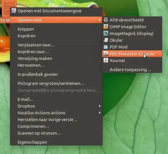

Another way to run it is right-click on a .pdf file and choose: "open with"
