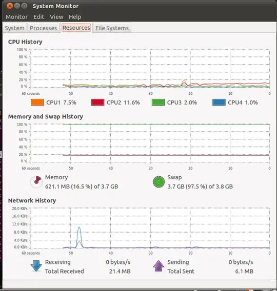

For some reason or another, my swap usage will peak to 100% capacity after a couple hours of usage. My interface will then freeze, after which I have to wait 20 minutes time to be able to even move the mouse.
The current suspected culprit is Chromium or XChat as these are always present when this issue occurs. I'm leaning more towards XChat as I've previously noticed the freeze starting right around the time when I click on something related to XChat.
Among the other things I've noticed is the Swap usage will build up over time.
I've also had Emesene and Dropbox open, but i doubt they're the root cause of the issue as they're just idling when the interface freezes.
Rebooting is currently my only fix at the moment, (That I can find anyway...)but if the interface didn't completely stop working, in that case it would be a hard reset. Also when the swap is full, the HDD light is constantly on. Not sure why this is happening
Edit: Found some additional information. Here's the output of free -m:
             total       used       free     shared    buffers     cached
Mem:          3760       3653        107          0          4       2638
-/+ buffers/cache:       1010       2750
Swap:         3890       2643       1247
As you can see, the physical memory is cached for some reason, while the free ones are relatively small. I think this is causing the swap usage.
I need this fixed as I currently need to shutdown every 2 days.
Thanks

vmstats after swapiness is set 10
procs -----------memory---------- ---swap-- -----io---- -system-- ----cpu----
 r  b   swpd   free   buff  cache   si   so    bi    bo   in   cs us sy id wa
 2  0 1458588 119320   2292 2748584    1   13    32    25   16  192  6  2 90  2
Why is the virtual memory usage so high? That's way higher than what both my swap and my memory can offer
Why is the virtual memory usage so high? That's way higher than what both my swap and my memory can offer.
smap info: These are long
Update: Here's recently an out of memory event (I turned swap off at this point, also the cached memory is taking up round 2.5GB at the point, and only ~1GB of physical memory is used, so technically I have another 2.5GB to work with due to the supposed taking back of the cache by the kernel):
Syslog event showing the supposed "out of memory event"
